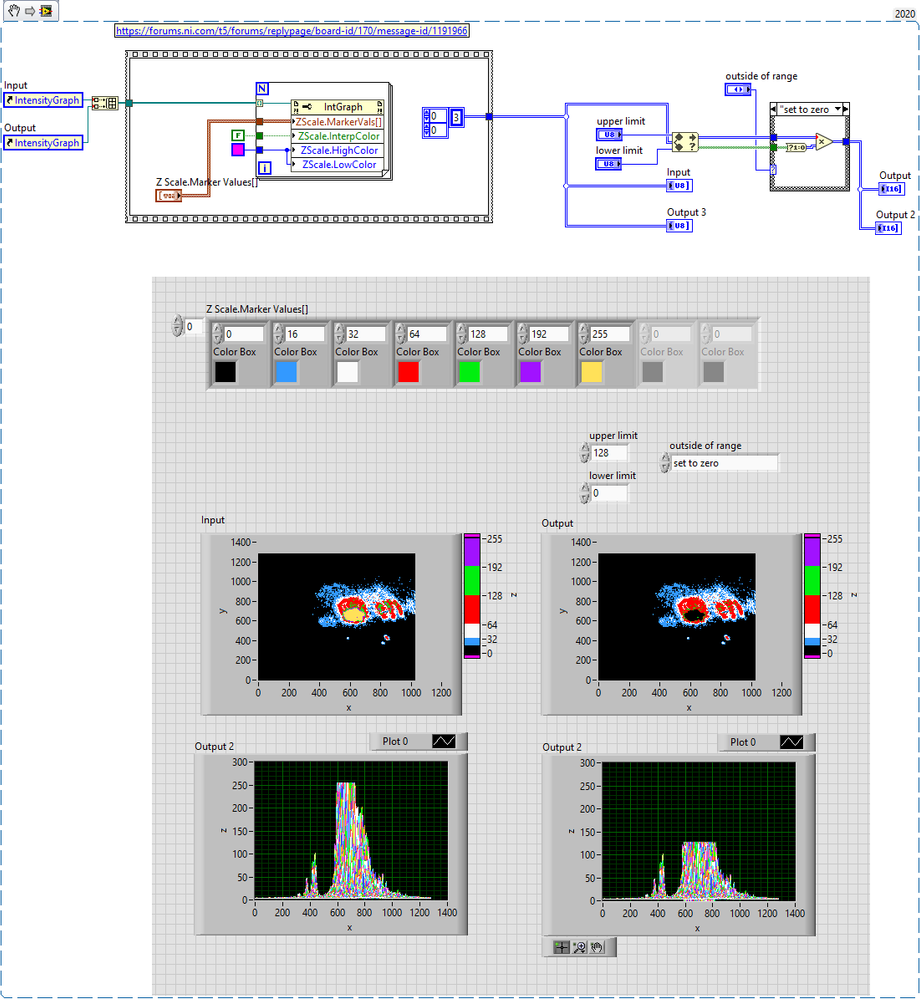

I'd do something like this

Thank you for the reply, I do have a question regarding your solution, why do you have two graphs going into an array builder? why do we need both going in.
This image is a grey scale image, can set the colours to be a grey scale automatically?
My final question (its a silly one). How does this function compared to the IMAQ Threshold VI.
Once again I appreciate your help.
Andrew
Message 9 of 19
(2,621 Views)
Hi Andrew,
Because both graphs are set to the same properties…
Yes. just change the colorscale settings (aka ZScale.MarkerValues)…
