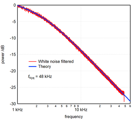

An Nth-order analog Butterworth filter has N zeros at 'infinity' frequency.
The magnitude response has to be 'zero' at the frequency where you have a zero. So in the case of an analog RC filter, this happens at infinity. As the number of zeros at infinity increase (i.e., higher the filter order), the higher attenuation at higher frequency.
However, in a digital Nth-order Butterworth filter, the N zeros are at fs/2. This means that the magnitude response has to be zero at fNyq and you see a sharper fall-off near fNyq.
Not sure what you mean by 'reproduce' a simple RC lowpass filter response but, no matter what you use (MATLAB, LabVIEW etc), there is no workaround from the sharp fall in magnitude response at fNyq if you use a digital Butterworth filter.

By 'reproduce' an RC filter response, I meant to match the magnitude and phase response of the RC filter up to fNyq (or very close). Below is the magnitude response I measured from a third-party digital filter (that the designer claims has also the correct phase response). I hoped I could replicate this in LabVIEW.
I should have asked: If this is not possible using the standard Butterworth filter can anyone suggest an alternative solution?

Hi David
Whose filter is it that you are trying to match?
I would say that the sampling rate is not too high to be over/up-sampled (they are different things). You also need to consider a couple of things:
  • Any signal above the Nyquist frequency will be aliased, so either you need to sample at a greater rate (over-sample) to avoid aliasing those frequencies or you need to have an appropriate low-pass filter before your A/D conversion.
  • A first-order butterworth filter has a slow transition above the cutoff. In the analog world, you would not have the Nyquist issue, but when doing digital processing, you do, so you need to work around it, and if oversampling is not an option, up-sampling the data post A/D is another option to preserve the frequency response right up until your original Nyquist frequency. Note however, that those frequencies are not well sampled so close to the Nyquist frequency (and indeed they may be already aliased higher frequencies) so the drop-off you observe is probably not a bad thing anyway.  If you really want to sample 48kHz then you should definitely sample higher than 96kHz.
