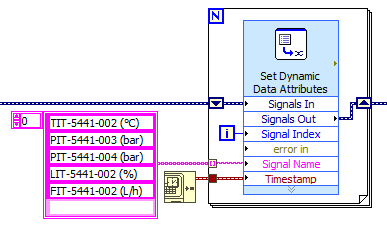

@Felipe_Alves17 wrote:
The states
1 - Idle
2 - Pump On, Generate New File and Record
3 - Pump On and Stop Recording.
4 - Turn Off Pump, Continue Recording.
5 - Turn Off Pump and Stop Recording.
Files cannot overwrite each other. When the pump button returns to TRUE, the pump must generate a new file.
It can go
1 to 2
1 to 3
2 to 3
2 to 4
2 to 5
3 to 4
3 to 5
4 to 5
See, now you just need a simple state machine!
Message 13 of 19
(502 Views)
My friend, thank you so much. I'll send you the VI. I just added mine and made the connections. I was following ChatGPT, and it was telling me to create a Case Event, which was making things more complicated than helping. But the solution you gave is very simple and straightforward. I'll send you the VI I made based on yours, and it's working perfectly.
Message 14 of 19
(491 Views)
Accepted by topic author Felipe_Alves17
Hi Felipe,
You really should take some beginner lessons to create more "LabVIEW-like" code!
See this:
  • Avoid repeating code when you can use an autoindexing FOR loop…
  • I prefer outputs being set instantly (pump/recording ON) instead of waiting for the next iteration…
Btw. when attaching VIs you should rename them instead of pretending "modifications by CA" by still using the "_MODCA" in the filename!

Thank you very much, I will have to learn a lot of things indeed. I liked the way you used the FOR loop, my concern was whether the columns in the spreadsheet would come out with the names of each variable, since I was inserting the name by double-clicking on each block in signal name.I will test it the way you showed, it makes the code much simpler. Do you have any tips to improve my programming method and to use conditionals in the best way?

Personally, I would even use an array of strings instead of scalar string followed by built array. Fewer cats to herd... 😄
