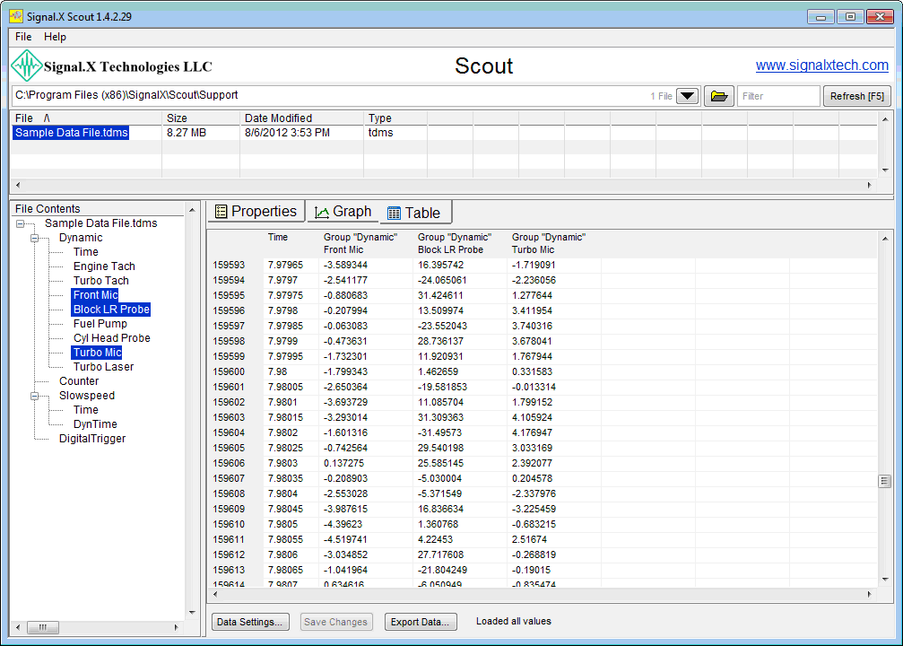

Looking more closely, I see that the tabular data on your website has a time column before the y-data columns:
My TDMS data doesn't (although as stated the dt is embedded in the proper location):
Scout Table.png0
Maybe a workaround would be to add a "Time" data column?  Is there a simple way to do that?  The TDMS Write.vi doesn't seem to do that by default [by just wiring in array of waveforms, group name, and channel names (I also tried not wiring in channel names since the names are embedded in my waveform attributes but got the same outcome.)].

Hi LabBEAN,
Thank you for your interest in Scout. I am one of the primary developers for that product and I am happy to help with your questions.
You mentioned that the X axis was not working with Time units. The answer is the dropdown in the upper-right corner of the graph area. In your screenshot, you have selected "Index (dx = 1, t0 = 0)", which is a way to ignore the wf properties by design. You want to choose the option "dx and t0 from file", which will use the channel properties when creating the X axis.
You also have the option of selecting any one channel to serve as the X axis, found in the same dropdown. This is what you see in the screenshot you referenced from our website, where a channel called "Time" was included in the TDMS Data.
We are always looking for ways to improve and we really appreciate the feedback.
Thanks, and have a great day.
