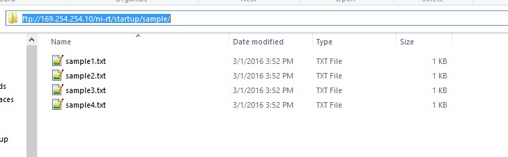

I can't retrieve file list from FTP server of my RT target
My VI gets stucked on FTP directory listing VI and returns error after one minute. I tried searching for FTP tutorials and samples but I can't find something that is the same with this.
Here is my Code snippet. I also upload a LV13 version my code.
this is my directory that was trying to get
and this was the error
Can someone help me with this?

What is your RT target?  Any of the Linux RT have FTP disabled by default for security reasons.  NI recommends switching to WebDAV.  But you should still be able to install the FTP driver on the RT system if you really want to stick with FTP.

I installed FTP using MAX. I use CVS 1457RT
(5,077 Views)
Have you tried to use the absolute path /ni-rt/startup/.... rather than the relative one without leading slash?
The FTP servers current working directory may not be in the root when you attempt to list the contents. Alternatively try to execute the pwd command to see where you really are located!

Thanks for all the advices. I managed to perform my task using webdav and also performs webdav get.
