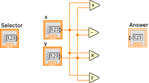

How to write a LabVIEW program for conducting selected arithmetic operation (+, ─, *, or /) of two numeric values?
On the Front Panel, it has 2 Control inputs, one selector, one display showing “The current operation is ....” and 1 output Indicator.

I have no idea how to select different answers due to the input.

Then you should take a class on basic programming (not neccessarily LabVIEW)…
Suggestions:
  • When you want to select between several cases you should use a case structure!
  • Delete that "Selector" control and create an Enum control.
  • Create items in the Enum corresponding to your required math operations.
  • Now wire that Enum to your case structure and "Create a case for each Enum item"…
