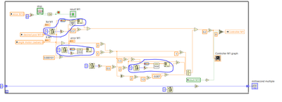

Usually I put only one Wait for each loop that acts as a delay between iterations. However, as I said I just refer blindly to my "senior's" coding  as shown in Figure below, she put wait function for every derivative or integrator block. This is why I don't understand. I could not manage to ask her as she already graduated and fly back to her country. Figure 1.PNG

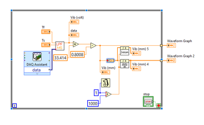

I am trying to do as yours, but I have got broken wires since there are two different data type.
Then, I keep the datatype as before :
I'm trying to run, unfortunately the reading is still zero at the output of derivative block  (Vib (mm) 4). Then, I I removed the LPF, the results are still the same as 

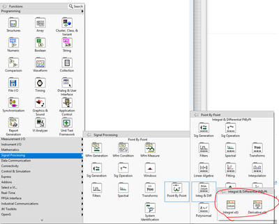

GerdW has used the point by point differential block
Message 14 of 20
(2,415 Views)
Accepted by mansamewoi
Hi mansamewoi,
No, you don't do as me: I used Pt-By-Pt functions from signal processing -> Point-by-Point palette…
(Do you see that red arrow in their icon?)

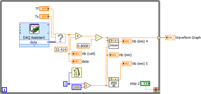

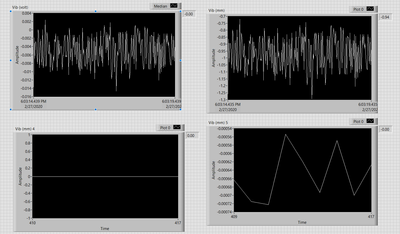

Sorry, my bad. I just knew there still have another blocks for integration/derivative. BTW, why do we need to divide by 1000? what does it mean?
another thing, I also try to use another continuous derivative block as here as
and I've got the same pattern of the chart with different values of y-axis as
How to use continuous derivative block?

The /1000 is converting milliseconds to seconds. This will result in your output having the units of  change in value/second. (V/s for example)
I've not seen that second block you have added before, but it looks like an express VI and I am guessing that it is giving you an output which is change in value/millisecond (e.g V/ms) seeing as the y axis is 1000 times smaller

It is up to you. It depends upon what you want your output units to be.
In the detailed help it gives the equation for the maths which is going on. When you wire the dT terminal you are just supplying a value to use as dT in that equation. if that is in seconds and you measurement is in volts your output units will be V/s, if you put milliseconds into the dT terminal your output units will be V/ms.
