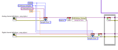

I need to synchronize two tasks - one for analog and one for digital data collection of waveforms. I have looked for examples and what I find is "Analog Input - Sychronization.vi". I am stuck because there are quite a few different styles of synchronization in the case statement and quite a few notes about details I know nothing about regarding various chassis or module types.
This is where I currently am where I have two different tasks that are not synchronized. When I run this I get a pretty significant difference between each task regarding when they start - up to about 0.1 seconds.
My equipment is a cDAQ-9185 with two modules:
  • NI 9205 voltage
  • NI 9425 DI
Is there someone who could kindly point me in the right direction on how to synchronize these tasks?

When possible, I like to sync with a shared sample clock as shown in the code below (a small mod of your posted code).
A trigger is another way to sync tasks, but only if they're on the same device or in the same chassis (cDAQ or PXI).  Otherwise, only the very initial start is in sync, but the clocks of the separate devices will drift apart from one another over time.
The effect is more pronounced for longer acquisitions that last hours or days.  But it's present even in shorter acquisitions.  A decent rule of thumb is that data acq clocks in different devices may differ by a few millisec per minute of acquisition time.

@Kevin_Price:
Thanks for that! I am getting an error I do not understand though. The error is on the Analog 1D Wfm NChan Node and states:
You only can get the specified property while the task is reserved, committed or while the task is running. Reserve, commit or start the task prior to getting the property.
 The VI goes ahead and collects the digital data but does not collect data for the analog channels.

Since you are on the same cDAQ with your modules, try to select the ai-Sampleclock directly:

Sorry about that.  Some tasks let you do that query without reserving first.  Not this one apparently.
Insert the "DAQmx Control Task" function between the timing config and the terminal query and set the 'action' input to "reserve".  Then the terminal query ought to work, and the lack of error should allow the analog capture to work too.

Kevin_Price:
No need to apologize! You helped me get past this hump and I learned there is a whole area of LabVIEW that I need to learn. Thank you.
Currently I am getting excellent synchronization. There is a 0.0000000500586 of a second difference. I guess 5 trillionths of a second will have to do! 🤣
This is what the timing part looks like:
Message 7 of 10
(6,166 Views)
FWIW, you'd get the same level of sync by following the earlier suggestion from JensG69.  Both establish the same hardware timing signal routing.  His method is simpler and more explicit so often preferable.  Mine is a bit more of a pain and only advantageous if you have multiple analog tasks on your cDAQ chassis and the one you need isn't using the default AI timing engine.  (cDAQ chassis offer multiple timing engines to support independent analog tasks on different modules.  When you use just one, it's going to be the one designated "ai".  When you use more than one, the others use "te0", "te1", and so on.  If you happen to be in a scenario where you don't know which timing engine will get used, you'll be more sure of success with my querying method.  But also keep in mind that most users don't seem to get into such scenarios much.)
