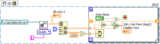

Hi all, I have a VI that basically automates a temperature ramp. once the Ramp Temp button is pushed the VI pull two rows of data from a .csv file (Setpoint and duration) to create a temperature ramp. All seems to work find but in the case that I would like to disrupt the ramp and go back into manual mode, I can't stop the VI while it's holding its wait time. Is there a simple way besides aborting the whole VI since this is a small part of bigger VI? Thanks in advance!

the usual answer is: avoid long-running wait function calls!
When you want to wait for (lets say) 10s you can also wait 20 times for 0.5s…
Btw. your inner loop could by simplified to:

Thanks Gerd that was a quick response! Yeah, I came to that conclusion. Your loop still will not work since you have the long wait and the3 conditional terminal will only execute after the delay. I'm thinking to just put a constant on the wait at 500 and double the time and put it to the N count terminal of the for loop. At least it should be able to pick up a stop command every 500ms.  On another note, your simplified version causes the output of the index array to change from an element to a subarray. This would be an issue for the input of the N count and next to be converted.

I don't see any subarrays in Gerd's VI snippet.
All he did was take what you had and simplified it.  He only told you how to improve upon it.  He didn't code up his suggests for shorter waits and repeat reading of the stop button and more frequent intervals.

I was looking into this and running into an issue with it (my lack of experience with it). I going to hit up Gerd's idea with a for loop x amount of time with a smaller wait delay so I can stop it. When I have more time, interested for sure into the timed sequence and the stop option. Thanks!
