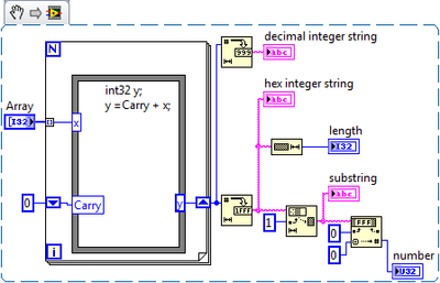

Hi Guys
I am using UART RS232 protocol and i need to calculate the check sum. My data came in decimal and in the end it must be doubles to manipulate it. So my problem is, for example, the sum of all elemants is in decimal 1742 and in hex is 6CE and i wont only the last two elemants, CE that corresponds to 206 that is the result of my checksum. Can anyone help me?

I think this is what you are going for.  Your main issue is that you want to use String To Byte Array.  Each of those numbers are bytes.  To treat them as bytes instead of ASCII characters.

i dont know if it fits to your req. because my input is array just sum them up and convert to string...

Thanks Syrpimp
My data came from HMI in decimal like the example that i show above. Each cell is a value. You used an array, but i think that i can't use it because it must be done automatically and the data field have variable length.
The UART protocol frame has a start frame field that corresponds to two ‘{‘ characters and an end frame field that corresponds to two ‘}’. Additionally, besides the data field, that has variable length, it has a byte that corresponds to the command type and another that is the checksum. The following table illustrates the protocol.

I highly recommend viewing your string in Hex display and change your numbers here into hexidecimal.  Things will make a lot more sense.  Then go look at my post above.  It does exactly what you are asking for.

Hello again
I tried exactly has you told and the result isn't ok. See the attachment.
Message 9 of 23
(5,230 Views)
Your input data isn't correct.  I can tell because it should be starting with 7B7B and end with 7D7D.
