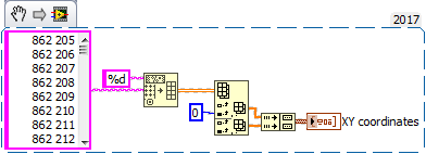

Thank you for your fast solution. Only Problem is that my set of Pixels coordinates are in the form of string shown in the attached iage.

When im trying to convert the spreadsheet string into a 2D Array, ist giving me an extra column in Array indicator. Also, im confused how to convert this 2 D Array into  Cluster of Array (Cluster of X, Y coordinates) as you have shown in the VI.

Hi enthusiast,
basic rule: when YOU have problems with YOUR vi then YOU should attach YOUR vi here so WE can examine it…
There is a nice IndexAndBundleCluster function:

Sorry i didn't upload my VI in the first place. My whole application is a big one and here is a small Code in which I am stuck after converting into the 2D Array. can you help me in how to procedd? I tried with IndexandBundle Cluster before but i am not sure how to connect the dots to be same as your VI you have posted at first

Hi enthusiast,
use my code above to compare your XY coordinates:

Thank you so much. I got the correct solution from you.
