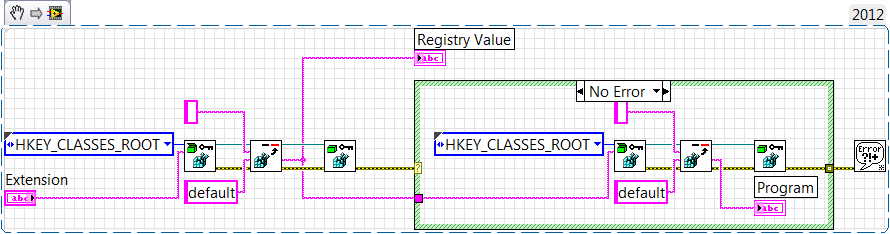

You can read the registry to get the program description. The extensions would need to be registered already (or exists already) in order for this to work. See example attached.

Thanks guys for the fast response.
SumTumWong,
I have tried out your idea however if I take a file extension it always finds the same program and Registry Value for both of the files. What I think is happening is that two programs (Program#1 and Program#2) are installed on the computer that have the same file extension association.  Since Program#2 was installed most recently by default any file that was originally created by Program#1 fails to open up in Program#2. So I would like to tell the difference programmaticlly by using LabVIEW. So somehow I need to get the information about each file that will describe with what Program was each file created.
