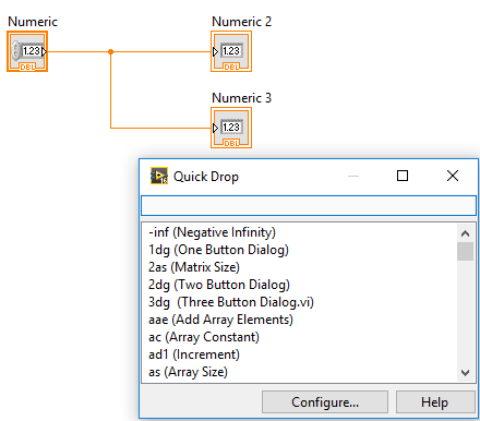

Here are 3 nodes, I wanna delete the "Numeric 3", but WITH the wire.
Step 1: select the node:
Step 2: press Ctrl+Space:
Step 3: After pressing Ctrl + R, the result:

Sorry I should have mentioned that I want my other blocks nearby to remain at the same location. It seems Ctrl+Space Ctrl+R will rewire and re-organize those blocks..
Message 4 of 8
(3,492 Views)
Selection + Space semms to do what I want but then I find out that it can only select wires to its "turning corner" but to till its node.
It does a Wire cleanup after removal, but blocks should stay in place.

Yes the blocks stay Smiley Embarassed Thanks
I prefer the shortcut more without rewiring.
