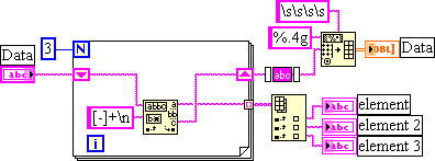

Here is a (big) hint.
I'd give you a snippet but I haven't updated this machine yet.  That's a pretty annoying delimiter, if you know what is good for you, you'll start using commas, tabs or single spaces (my order of preference).  It is way too easy to start adding or removing spaces and then you'll have to resort to more complicated methods to get the spreadsheet data.

Hi Darin,
Still a small question for you. I tried "7.0000E+2" for the search term and successfully got the data array seperated from the file and the whole thing before the data as a string. But when I try "--------------------------------------------------" for the search term, I got no luck. The first part of string (before the first -------) gets in to element, but the rest just all streamed into the Data array. I don't know why seems that the for loop just executed once. I'm still trying to figure out this. Anyway, your hint solved my major problem and the rest will be easy for me. Thank you very much.
Richard
Message 9 of 13
(4,546 Views)
I'll wager you put one too many '-' in your search string.  BTW, the [] in the regular expression are left over from an old example, you don't really need an alternative when there is only one character, "--+\n" should work as well.  I'd use two '-''s in case you have negative numbers or dashes in your comments.  You've got the idea, and the detailed help is very useful.
