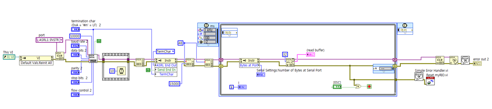

I'd like to read Xsens sensor(MTi-1s-DEV) data into Labview using MyRIO.
I connected sensor to myRIO as below.
I also switch the sensor to UART FD(Full Duplex) interface.
Then, I used VISA function in Labview to read sensor data like below.캡처.PNGHowever, VISA function reads a strange data... you can see it in the image below.
I don't know what is the problem and what is the way of solution..

It seems to me that you are displaying the Reading as normal strings and from what I read from the device you are trying to communicate with  the device sends the data in hex format.
Change the string indicator property to Hex and check if the resulting data make sense to you.
