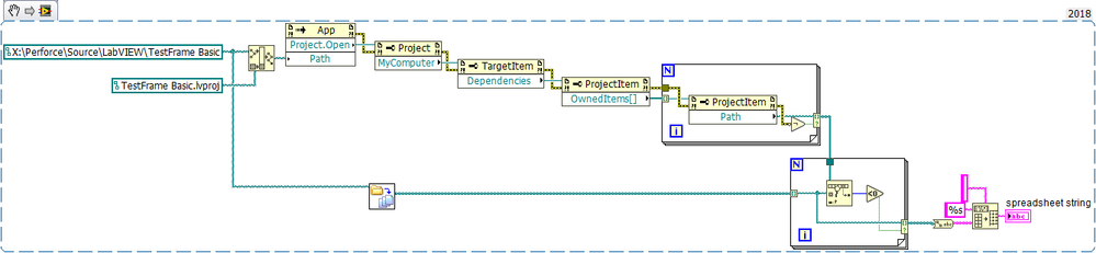

This works for classic LV.
Fortunately, I don't know how to do anything in NXG.
