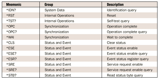

Well you could see if it responds correctly to a couple 488.2 common commands.
IEEE 488.2 Mandatory Common CommandsIEEE 488.2 Mandatory Common Commands
 See also : GPIB Hardware and Software Specifications

Then those instruments are probably 488.1 compliant, not 488.2 compliant.
For an instrument to be IEEE 488.2 compliant it MUST respond to the list of 488.2 Common Commands I posted above.
I tried this option. The issue with this is - We are trying to do a silent check regularly if the connected GPIB instruments are IEEE 488.2 compliant or not. There might be other software/tools which are communicating with the GPIB instrument regularly. So if we do a query, it might disturb the query (query with a wait time) sent from the other software/tool. And we do not want to do that.

Aside from looking at the label on the instrument and the documentation, there is only trial and error. The IEEE 488.2 is also not exactly a standard put in stone. Many devices in the past did sort of implement IEEE 488.2 on software level but had due to the use of buggy interface controllers not exactly the full IEEE 488.2 hardware compatibility.
And the software level is a chapter of its own. While the above mentioned commands are part of the actual IEEE 488.2 standard, the rest is SCPI based and that is more a recommended way of implementation than a standard.
And even those IEEE 488.2 commands are not always fully implemented but should not cause errors when being issued.
But to find out if a device is IEEE 488.2 compliant (it may still not be fully compatible) you have to talk to it and doing that while someone else is talking to it will surely cause trouble.
