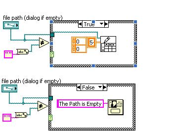

If the path is empty dont allow the spreadsheet file to read or write.
17207i18D2419D52E7A0A8

that works, but sometimes I have encountered cases where a dialog allowed you to pick a file, when it was read later on. In the mean time the user could move or delete the file, which of course happened -against my anticipation 🙂 -
I'd like to use the 'valid file or folder' VI to check if its still there.
