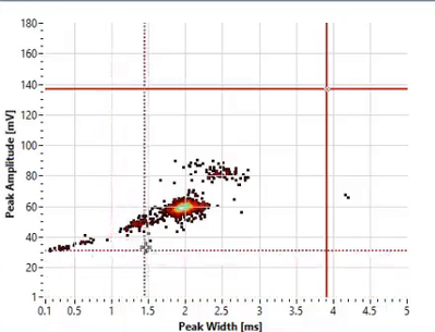

This is the type of plot I want on my front panel as a scatter plot

Just create a 2D array of sufficient resolution and map you data into it, the display in an intensity graph.
Create a suitable color ramp for the z axis.
Is the colored island some surface fit to a model?
Again, can you attach some typical data and also maybe show a picture that has a bit more resolution and also tell us what the color code means?

I don't have any data yet, above screenshot was from a research paper describing the prototype I'm building. It shows a pulse signal, where each peak corresponds to a passing droplet. I need to plot peak amplitude versus peak width, and the plot should highlight areas of data point accumulation by increasing their brightness or color. This visualization will help in setting threshold values using cursors.
(Instead of plotting each point as a simple marker, my interface brightens the color or increases the intensity where many points accumulate.)

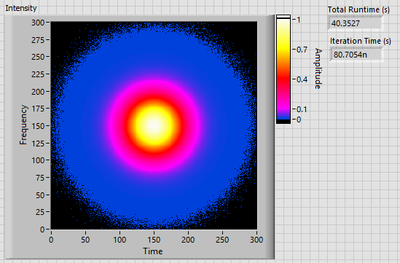

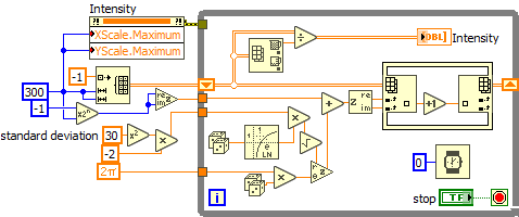

Here's a simple example how you can basically a 2D historgram (normalized count vs. x&y)
(In this case we simulate Box-Muller pairs quantized to the 2D array grid..

Just for fun. The same image, but after 500M iterations (about 0.119 ms per iteration, i.e. it took 16 hours and 28 minutes):
It took that long because you probably redrew the graph every iteration. If you move it outside the loop it takes me about 40 seconds to do 500M iterations:
