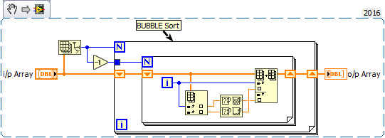

Try this code bro.it works perfectly in LabVIEW 2014 and later.KudosSmiley Very Happy

Hi Prabsun,
apart from posting in an old thread: why do you post such inefficient code?
After some cleanup work:
You might even use the Inplace structure:
Gerd already touched some points, but here are a few:
  • Why is your diagram and front panel maximised to the screen? Very annoying!
  • Obviously, taking the size of the array twice (once inside the loop) is redundant. The result never changes. Once before the loop is enough!
  • Before seeing Gerd's code, you haven't noticed yet that index array and replace array subset is resizeable.
  • Why do you do a "+1" of the same wire segment twice? Again, once is enough. (with resized nodes, it is not even needed, see Gerd's solution).
  • Your outer loop runs once too many.
  • Your inner loop runs way too many times. You can reduce the number of iterations by one for ever iteration of the outer loop. (further improvements are possible, see here)
  • If this is supposed to be a subVI, assign connectors and an icon.
  • If it is just experimental code, compare the result with he output of "sort array" and include verification code.
  • Your code does not work correctly if some of the input elements are NaN. It shoud create the same output as "sort array" in all cases.

@Prabsun wrote:
I'm just trying to help him.I'm not doing it for money or there is no requirements.If you want any changes,do it by yourself.
Writing code for a well delineated problem is a great exercise to learn programming and your contributions are highly welcome. This is a place to learn, so we sometimes take the opportunity to suggest improvements and this should be seen in a positive way. We all started learning once.
One of the best ways to become a better programmer is to try to solve a programming problem, and once it seems to work correctly (congratulations!) we can start focusing on little (or big!) improvements. We also need to make sure it works for all unusual inputs (e.g. empty array, some or all elements NaN, duplicate elements, Inf, -Inf, etc.). We should also explore how it behaves as the input array gets large (See also my NI-Week 2016 talk). Bubble sort is O(N²), so it scales poorly once the arrays get very large and other sorting algorithms are preferable. It would be an interesting exercise to do a few other algorithms and compare them.
Some of the veterans here have been programming in LabVIEW for well over 20 years, and this collective expertise and experience is a fantastic source to speed up the learning curve. Somtimes even we learn something new here.
Nobody gets paid here. We are all volunteers with an interest in spreading the word why LabVIEW is such a great programming language.
Your code was not bad at all! We've seen much worse. 😄 (there is a thread with almost 2000 messages discusing some really cringeworthy examples. 🐵
