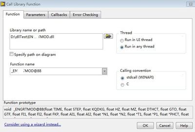

Note that the calling convention is important. If it's wrong, every function with more then 1 parameter will very likely crash.

If that doesn't fix it, you also need to check the calling convention as pointed out by Wiebe. The prototype you show doesn't show any calling convention declared which by default means that the function uses cdecl, unless the project file configures a different non-default default calling convention of course, but since we don't have the project build file available that is always a guess.
LabVIEW 32-bit for Windows defaults to stdcall calling convention since that is what Microsoft Windows APIs usually use, so it's quite easy to get that wrong too.

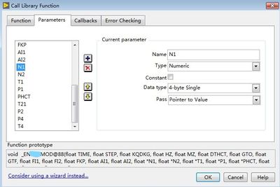

I had change the data type like 4 bit single, 8 bit double to define parameters to match the function in dll, but still got error of 1097.
Here is the details about calling the dll:

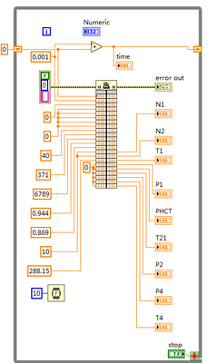

I use dll node and put it in a while loop which is same mode when it was used in VC6++, all the initial parameters are the same.
Here is error and details:
  1. Here is the setup using dll node in LabVIEW:

Thank you for your reply, I had collect what I had tried and put it below.

One very weird fact I see in your function name is that it is prepended with an underscore that is often used by C compilers when compiling cdecl calling convention functions and a @88 postfix which is usually done for stdcall functions. So which is it? It is not C++ name mangling though, but simple standard C name decoration.
Also @88 would indicate that the function has 88 bytes of stack parameters and your function has 22 parameters 13 of them are 4-byte single precision floats and 9 of them are references, so you are obviously using a 32-bit DLL (well considering that you still use Visual C 6 that is logical, it can't create 64-bit code).
Something is definitely weird about this but you seem to be onto something top secret here, indicated by the wiped out function names, so it will be up to you to figure this out. Without the DLL and VIs there is not much more we can do for you.
