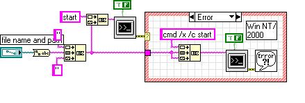

Here's my 2 cents.
Word is already set to open the document in windows so why not just use the system exec VI to open the document. this way it will always open with word. then you just close it when you are done. i do this all of the time with help files and such.
Here is the VI I created to do this.
Message Edited by Jhoskins on 10-11-2006 01:26 PM
Joe.
