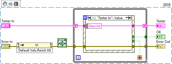

 Here's an example.  This is a "Two-Button Dialog Box" that asks the User to enter the name of the "Tester" (the person running the test).  The user pushes "OK" once this is done, or pushes "Cancel" to mean "Oops, I don't want to do this right now, tell the program to stop".  Notice that the Front Panel includes a Decoration, a Flat Box (I've made the edge of the Box transparent) -- this allows me to manually size the Front Panel so as to hide the Controls and Indicators I don't want the User to see (or use an OpenG function, shown in Green on the Block Diagram Snippet, to do it for me).
The Block Diagram is simple.  It largely consists of an Event Loop, here ended by pressing either OK or Cancel (which sets the OK Boolean Output to True or False).  It would be easy to add code to (a) require that the User fill in Tester, (b) allow typing "Return" to end the Dialog without needed OK or Cancel, or (c) put a time limit on how long to wait.
The only other "extra steps" are to make this VI a Modal Dialog Box.  That you do by setting some VI Properties.  Start with Window Appearance.  Choose "Dialog" (oh, really?).  If you now click "Customize", you'll see that this does the following:
  • Turns off the Scroll Bars
  • Shows Front Panel when Called, and Closes Afterwards
  • Sets the Window to Modal
  • and a few other things
Now go to Window Run Time Position.  I usually choose "Centered", but you can position it where you want (or leave this alone).
I'm also attaching the VI itself.  It is written in LabVIEW 2019, but you should be able to recreated it from the "picture" of the Snippet, as the other two Cases should be obvious (both set the Stop Indicator to True, while OK returns True to OK, while Cancel returns False).
