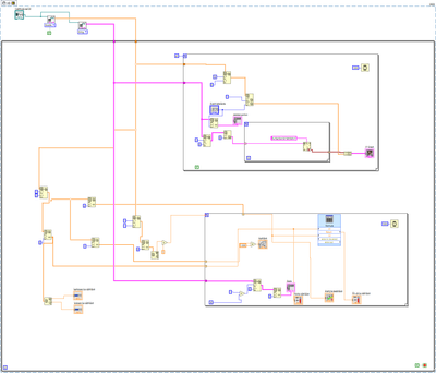

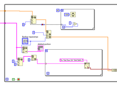

I have a graph of parameters, but it is static, I realized that I need to change the index value so that new values are added and the graph itself is drawn. But I'm just starting to learn LabVIEW
and the only thing I came up with is a timer in a loop that changes the iteration, but I can't connect it to the index. Please tell me how can I do this?

From your description, I can't tell what you're trying to accomplish.
You code makes no sense; and it is messy.

I'm trying to figure out how to make this graph appear gradually, such as one each new point once per second, rather than the whole graph at once.

See attachment for a way to do it.
  1. Clearly you don't have a good understanding of data flow.  I strongly recommend that you go through the online LabVIEW tutorials.
  2. When asking for help, there's no excuse for not cleaning up your code before submitting it. I usually don't help those who submit messy code.

I don't have the time to figure out what you are trying to achieve, but I did some little changes that seemed resonable. At least now your VI is running.
