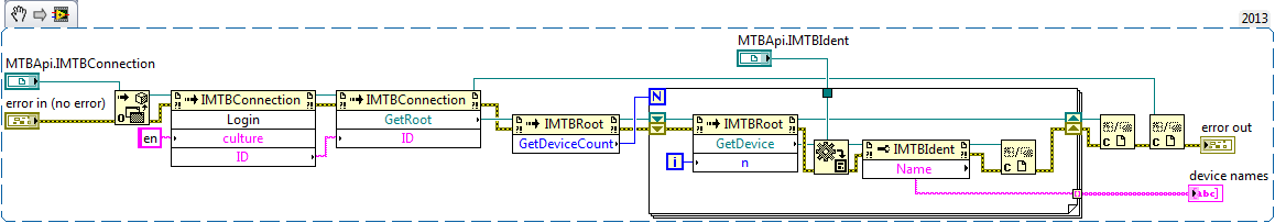

This looks very much like a an ActiveX library, but the type library is not included but distributed as a seperate file. As such you should look into the ActiveX functions in LabVIEW to import it into LabVIEW.
Something like following should get you started. The typecast from the refnum from the GetDevice() method I'm not sure about but the rest is basically exactly what you source code example you posted is doing.
You will need both the .tlb and .dll file in the same folder (preferably in the folder where you also save your VIs for accessing this library, and have to point the MTBApi.IMTBConnection refnum to the .tlb file.
Rolf Kalbermatter  My Blog

Hi
Thank you for your answer. I tried the code. When launching the code there is only one error after the execution of IMTBIdent property.
Message 7 of 16
(6,526 Views)
Well I checked in another project and ActiveX refnum typecasting needs to use the Variant to Data function. Does this work better?IMTBConnection.png
Message 8 of 16
(6,523 Views)
Hi
Unfortunately the situation is the same.
Message 9 of 16
(6,515 Views)
Does the Variant to Data node throw an error or does the IMTBIdent->Name property give you an error? And what error code do you get?
