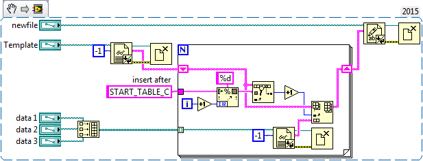

I would use Read Text File.vi instead of Read Spreadsheet File.vi Right click the function and select "read lines" and then set the count input to -1. The output will be a 1D arrary of the file lines. Then use Search 1D Array to get the index of START_TABLE_Cx (add 1 to the index to add after. Finally use Write To Text File to write to the new file.

Ben, Thanks, it works for one data file insertion into template but I tried doeing it for multiple data file insertion and didint work for me, it overwrites the sections.
I am attching the rsult file also

You need to do the new insertion in the previously modified array.

Here is a more compact and efficient way to do it. You could eventually replace the path array input section with the Recursive File List VI. (from the  File I/O - Advanced File Functions palette, have a look at the help file, you can search for a pattern in the filename and it returns an array of the file found paths).

Hi Ben, Thanks, it works fine.
I also modified/added to it,  so that instead of file path , serial number of data files will be entered/read from operators input , and data file will be found in the folder to be read and pasted to the template.
