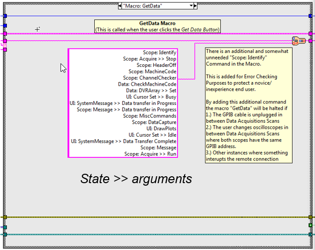

  2. Built in Event Structure - I use it for FP events and dynamic events such as User events to communicate between loops or a DAQmx Event such as Change State to trigger something, or I use the DAQmx event number of points in the buffer to periodically download data. Why events, no polling needed.
  3. I prefer to make a multi line "macro" of states to execute, rather than build an array of enums
  4. If a make a multi line "macro" of states easy to comment out a state for debugging purposes rather than remove an element from an array. Below is an example of a macro, if I want to comment out a state I add a # at the beginning. Also it is easier to reorder a bunch of lines of text rather than an array.
  5. Easy to add arguments to state. I would rather have one state with two arguments than two separate states. For example UI: FrontPanel >> Open, and UI: FrontPanel >> Close. The advantage is I can add more arguments if needed, like hidden, maximized, etc without added more states and largely duplicated code. Or I have a message state and the argument is the message.
  6. JKI added some nice tools like State Machine Explorer that makes programming easier.
