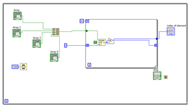

Please find the VI and images,
I want to know the index of the last true value of the boolean array. Please let me know what mistake im making. This index required for the case structure to display notifications.
The array has 64 elements. For loop N has 63, in my case the last (64 element) is true, but it is not showing as required.
Sometimes elements 64 go off and 60/61 becomes ON, so last element 61/62 should show.

You answered it yourself, you have 64 elements but only look up to 63rd.
The index value goes from 0 to 63, but the N value needs to be 64.
EDIT:
Looked at your code and you also have it hooked up wrong. Looping through the array 63 times, but Search array function returns -1 once it hits the last element that fits.

Thank you for the answer. However i am not getting the 64 element as shown in figure. Can you please check if you have labview with you. the picture attached for reference.
the idea is to get out of 64 elements, which one is true & that is last out of 64. (ex. elements 5, 10, 15, 50 are true, so index should show 50. )

try this
The mistake you made was looping through all elements, even after you've already found the last value, thus it returned -1. You should stop searching once you find -1, so while loop would be more appropriate.

The last True is the 1st True on a reversed array ...

Yamaeda's suggestion:

Thank you for this, I tried this but still same result. this solution would have worked for me if i am stopping while loop, however i cant stop the while loop as some other system readings are being monitored. Yamaeda solution worked as required.
Thank you all for all the inputs.

Thank you,
I tried this method, it works as needed.
Only thing i have to re type or copy paste the strings in case selector in reversed order. This I will do. Thank you.
I assume there is no way to get the index without reversing array. Also numeric received converted to back same.
I assume you are referring to AeroSoul post about Yamaeda's solution.
There are no strings or case selectors in your code or AeroSoul's code. What case selector are you talking about?
Yes, you can find the index without reversing the array. It would be slower and more complex.
Not sure what you are trying to say here. I assume the meaning of this was lost in translation.
