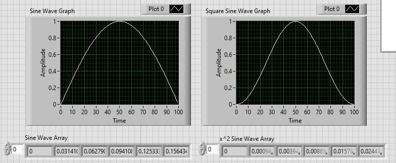

Thank you for your assistance!
I ma sending my last application, version 19.
Regarding your code, I see that the kernel that you using is an array with one row. Therefore I said that the kernel is not symmetric. The size of the kernel is 1 x 100 par example regarding the HkernelWidth. If I use a gaussian kernel from the Vision Assistant or regarding the theory, there are basic examples using kernels with size 3 x 3.
Therefore I am asking about the sine wave kernel is it possible to present it in symmetric shape or it is not necessary?
Here is the sine wave signal and the sine wave array that is not symmetric as I said.
My second question is related with the sum of the sum of the build array. Is it possible change the place of the sum as it is shown on the picture?
Message 26 of 41
(568 Views)
Your "background" is very blurry in x but has lots of relatively sharp transitions in y. We only want to blur in x to retain the sharpness in y The 2D shape should be based on the image and what we like to filter.
The sine kernel is symmetric once you remove the leading zero.
Of course it is "possible" but would not be correct! The kernel needs to be normalized. If you normalize the convolution, the convoluted signal will no longer have the same integrated amplitude as the image before convolution!
Have you even tried??? If you normalize the background such that the sum of all elements is one, most, or all, elements will be much less than one and you'll end up with a black background image and no useful subtraction.

In all web tutorials related with convolution kernels, the size of the kernel is equal to 3 x 3 (a square). In your code the sine wave kernel has a size equal to 1 x 100 (1 row and 100 columns). What is the difference between both sizes? I'm confused because of the sine wave kernel size!
Regarding the normalisation of the kernel I understood that this is a practice when working with image processing. Thank you for the clarification!
Message 29 of 41
(540 Views)
A convolution with a 3x3 square kernel is the same as replacing each pixel with the average of the 9 closest pixels, which is just a mild noise filter (sometimes called a "box blur", see link below). A kernel that is tapered will do a weighted average where the weight decreases as a function of radial distance. Other kernels can do sharpening or emphasize edges. (I use it to simulate spin system spectra, nothing to do with pictures!)
Start reading here. If the image features (the background here) is asymmetric (slowly changing in X and sharper in Y as we have here), nothing is stopping us from using asymmetric and much wider kernels. Here we pick a width that completely obliterates the cells, but retains the background with little distortion. Have you tried playing with the controls yet as suggested? There is a reason they are not diagram constant!
It is required for all convolutions (1D, 2D, 3D, etc.) if you want to keep the average brightness of the image, else you change the scaling of the signal. Of course there are exceptions where the kernel sum is equal to zero. For example a kernel of [x, -x] will take a scaled derivative of the signal.
You can make your own box-blur by iterating over each pixels using a stack of two FOR loops, take the 3x3 subset centered on it, take the average, and output a new value, creating a new 2D array at the indexing output tunnels. It will be tedious and slow. Convolution as implemented in LabVIEW does a multiplication in the Fourier domain which gives the same result, but is significantly faster for large datasets.
