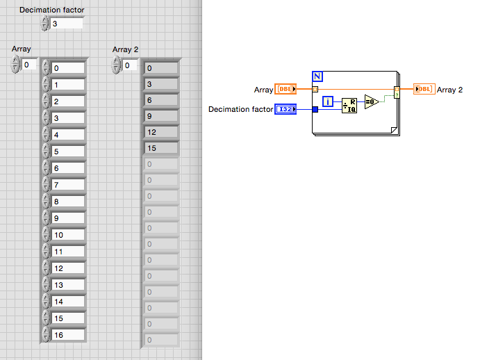

How to extract every nth element from an existing 1d array
Ive reviewed a few forums related to this question, but not exactly what i need.
I'm looking for a way to extract every nth element from a 1D array. The data in the array is very large so decimate function would not be helpful since i need to extract every 200th element from the array, and then build a new array with all of the extracted elements.
Any suggestions? Ive tried a few things and am feeling very stuck since none of them worked.

BowenM beat me to it.
Lynn

For older LabVIEW versions:
(and allowing the compiler to set output array size at FOR loop start…)

Also Reshape Array, then use Index Array to get the row or column of interest.

Thanks for your fast repsonse, i believe this is what im looking for except it wont allow me to wire my array through the loop like you have, error: wire connected to an undirected tunnel appears.... any suggestions?

never mind got it, thanks!!

I think that RavensFan's suggestion of using Reshape Array is usually the best for these kinds of operations.  Note that when indexing you have to wire a zero into the columns index terminal, or the column indexing will be disabled.
It also really depends what kind of noise and frequencies are in the data and what the data reprensents. In the worst case, just taking every nth element might give you all kinds of alias frequencies, distorting your data. You might want to do some filtering. Even just taking the average of chunks of 200 points might give you cleaner, less noisy data. (example)
