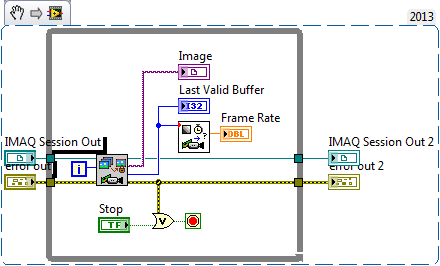

So to your question -- how to display every Nth image.  Here's the key loop (which is lifted directly from your code):
As menioned above, this routine is "clocked" by the Extract Buffer function.  What you do to display every N'th image is to put the Image control inside something like a Case statement that "fires" every Nth time.
Here's an "Nth" version of the above loop (some details omitted) --
We still drive the loop filling every buffer with a frame.  But we then use the Integer Divide function to select the Nth image (those that have a remainder of 0 when i is divided by Nth) and wire the "image" line (it doesn't really hold an image) to the "Image" control, with the other case being "Default" (so all other valeus go there) and with nothing inside.  Thus every Nth time through this loop, the output of Extract Buffer is wire to an Image (and displayed), the other N-1 times the wire goes nowhere.
