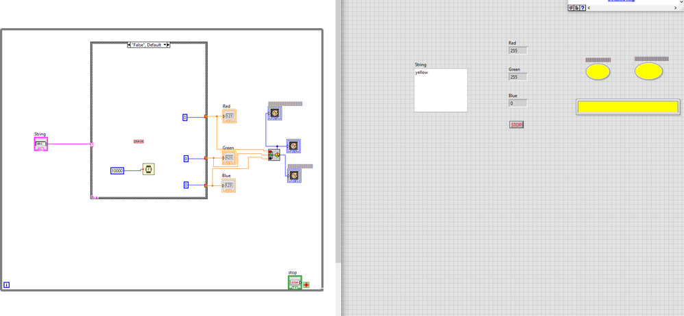

Hello, I need to make a labview program where it displays colors using rgb to color function depending on the input of a string through a case function. I need to display a message if its an invalid input and I am able to get a message using a sub vi but it keeps opening because I am using a wait function inside a case structure to run it. The hints I was given is I need a case structure, sequence, wait function, and sub vi but I do not have the sequence still.
I have a download if anyone is able to look at it.
My suggestion: use an event structure inside the big while loop.
Now you can only execute the code when the string input changes…
