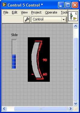

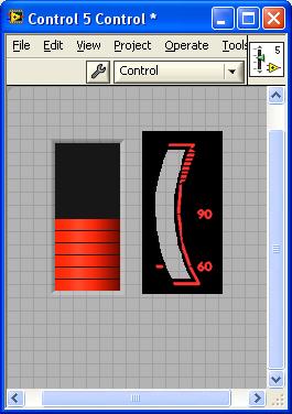

Use a decoration with parts transparent (I used PP to do this part) to over-lay a vertical prgress bar as shown here.

Use a decoration with parts transparent (I used PP to do this part) to over-lay a vertical prgress bar as shown here. If you really need all of the values and the arrows than a Picture control will let you render the image.

Meenatchi wrote:
Can you please explain in detail about how to create a transparent image to over-lay a vertical prograss bar
1)
Edit your image so that you have a single color used for the soon to be transparent region.
2)
If working in Paint ctrl-a to select all and ctlr-c to copy it to the clip-board.
3)
Open PowerPoint >>> new document >>> ctrl-v to paste in your image prototype.
4)
Right-click picture (still in PP) >>> Show Picture Toolbar >>> click Set Transparent Color
5)
Click on any pixel that is the transparent color in your prototype image. It will now be transparent along with any other pixel with that color.
6)
ctrl-c to copy the image with transparent regions.
7)
Back in LV ... drop vertical graduated bar >>> right-click >>> Advanced >>> Customize
ctrl-v to paste from clip board
 9)
Hide label , Adjust colors and size
10)
Slide the overlay over the grad bar, close, save if you want, lather rinse repeat.
Please post an image of your version to help others with similar Q's in the future.
