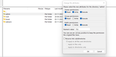

later on, I have checked the read/write permissions of NI Linux directory - for my device.
I found that, writing permission was not enable for group/public. After Enabling it, I can able to create file.
