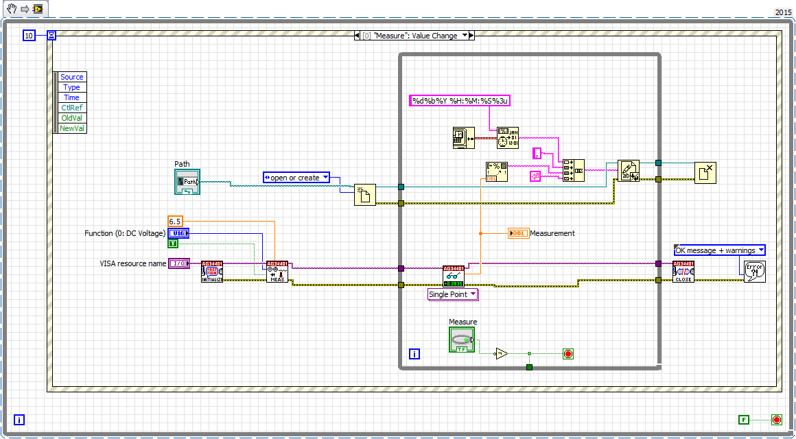

Fortunately I already know how a statemachine works and have years of creating them in C, C++, PHP, VBA, # ... languages and the examples on NI's website suck, do little more than show you the graphic with an explanation of what it does and no real step by step use.
From NI's silly examples I tried the following which doesn't do anything...lol

Accepted by rr1024
I am kind of old school and do not find much use for event structures but.... give this a try.
I am sure somene here that actually understand event based programming could do better.
Oh BTW: The timeout case is empty

RTSVLU,
Did you try running your VI?  It won't work.
Your event case is set to lock the front panel until the even completes.  You hit measure and the event case starts and the while loop starts.  The event case won't finish until you stop the while loop by hitting the measure button again.  You can't hit the measure button again because the front panel is locked.
A proper state machine would have in intialize, close, and a timeout for the event structure.  No inner while loop in any case of the event structure.

@RavensFan wrote:
RTSVLU,
Nope, I did not.
Like I said I do not understand the event structure. I think I have used it maybe twice since it was added to LabVIEW.
I know what you are saying about a state machine, 99.999% of my programs are a state machine. But I really did not want to totally rewrite the vi since the whole thign is a kludge to begin with, might as well kludge in an event structure.
BUT you are correct this entire vi needs to be re written from the start using a state machine.
