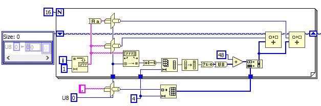

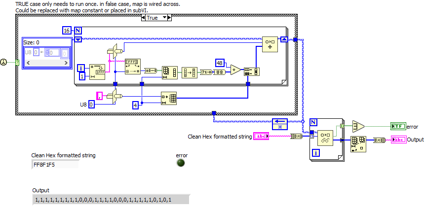

Also, if speed matters, you could use a map based lookup table (LabVIEW 2019 only, but workarounds exist for lower versions), leaving you with just a tiny FOR loop. There are many other (even more efficient) ways to do this, of course. You might also want to adapt it so it also handles lowercase a..f.
Message 5 of 24
(7,086 Views)
Just a tiny change when doing the map (now with 22 entries): 😄
Maps again? They are fast, but not that fast. An array look up will be faster!
