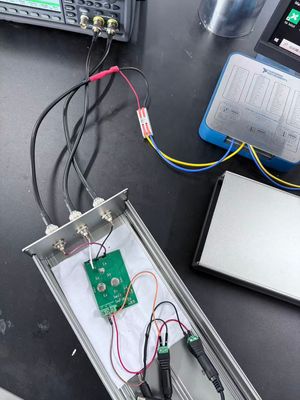

Hi, I just start learning Labview. I want to collect a sine wave (9V, 140kHz), but the wave collected is wired. Can someone help me please?

How did you connect the signal? Please share your wiring diagram.
Do you follow the recommendation in Field Wiring and Noise Considerations for Analog Signals?

The output connected to ai 0+, ground connected to ai 0-. The wave collected looks like a part of sine wave.

Your output BNC shield isn't grounded to the power supply, it is required.
What does the board supposed to do with dual supply rail?
How are you ensuring that your board is generating the sinewave which the DAQ is supposed to capture?

Thank you sir, I connected BNC ground to the power supply, the wave appears. But here's another question: It seems that the wave is a bit distorted. How can I solve it?
