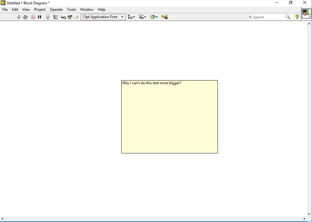

Hello to everyone!!, I'm new using labview, I was search for the solution of this problem and I can't encounter some solution :s . The problem is that when I have been sawing the tutorial of labview of NI of state machine, I notice that in the tutorial creating a program using this text for comment it:
I try to do some coments like that but I'm  only achieved this:
How I can do the text more bigger and in bold?

Font Settings are in the middle of the Menu bar at the top of the Block Diagram page.

In addition, once you have your diagram comment in a certain font size and just want to make it larger or smaller, select the comment and press ctrl+ or ctrl- to make the text smaller or larger, respectively. (it is actually ctrl= and ctrl-, no shift key needed).
(4,359 Views)
Hi Christian,
That's only valid for US-american keyboard.
On a German one I need to use <ctrl shift 0> and <ctrl ->…
