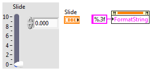

I want to change slider control digital display precision from my Labview 2013 program. I can not find property that changes slider digital display format.

rt clk the digital display>create>property node>format string
you could also do the slide scale, if needed...
from the front panel:rt clk properties>goto display format tab>goto drop down list and pick "digital display 0" and format

It works!!!
Thank you
