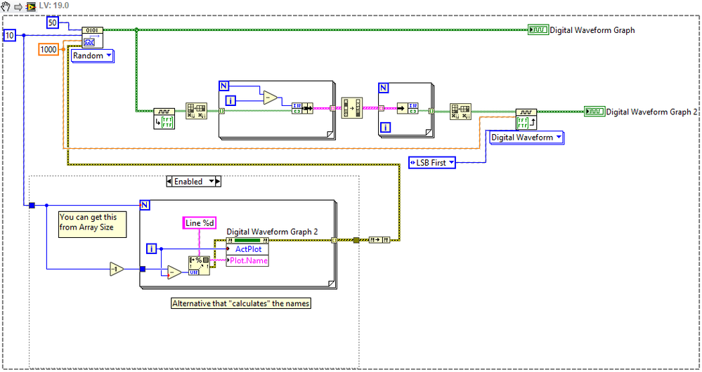

Here's an example doing what I think you want.
The label adjustment is automatic here, but it reads based on the previous run's plot labels. You might prefer to generate the names programatically (using, for example, Format into String).
As an explanation, I convert the Digital Waveform into a 2D boolean array, then transpose so that the rows are the lines.
Then I iterate over the lines, storing their future order (N-i) in the first element of a cluster, allowing me to use Sort 1D Array to reorder them.
Then I go back through another For loop in order to recreate the 2D Boolean Array, and use Boolean Array to Digital (Waveform) to get a new Wfm.

In response to a private message re I think the labels repeatedly switching?
The code I posted will switch the label ordering to invert from the previous ordering using the Property Nodes.
You probably only want to do this once, and there's not even any need to do it programatically if you know in advance your signal names.
A modified example that might be clearer what I mean (still using a programmatic setup, but now separate from the reordering of signals):
And with the other example of the DDS visible:
Here, I use Reverse 1D Array, but since the array is static I could easily have just written it in the opposite order.

It occurs to me in hindsight that you could simplify the reordering using the Array Size (or Matrix Size, convenient for 2D arrays) to the outside of N, then disabling autoindexed input and using Index Array with N-i-1 as the index.
Then you don't need the cluster or the sort, and only 1 For loop.
