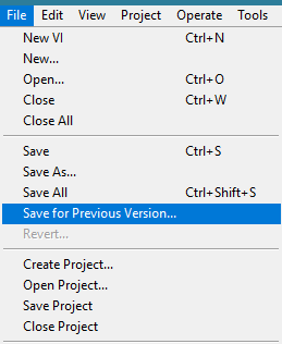

Please save your vi for a previous version like this:
You have to specify your file path differently for the Development and Runtime environments like so:
Also be sure to include your file in the correct directory. It is easiest to add the file in the Always Include section of the executable builder.
