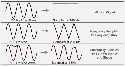

Nyquist theorem states that you need to sample at a rate of at least twice the signal frequency. Since your pulse train is 2kHz, your AI sample clock should be at least 4k, although you should use 5 to 10 times to capture the waveform correctly. Is there any reason why you cannot use a higher sample rate on AI?
