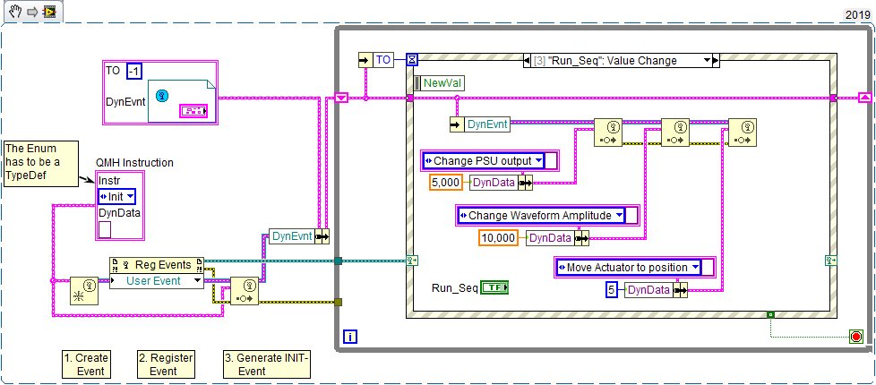

I like this approach:
Greets, Dave

Hi Dave,
That's awesome. This is exactly what I'm looking to achieve.
Awesome. Thanks.

But I didn't do your homework, didn't I?
Greets, Dave

I'm really not convinced about recommending a custom design pattern so different from the basic ones (QMH, State Machine) to a beginner...
There plenty of ressources about basic design pattern that solve this problem.
Loïc.
