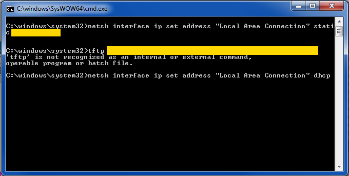

I don't know if it's a side affect of the forum update, but the snippet is not working.
When I try to drag and drop it, all I get is a red "no" circle.
So I built my own version.
I am trying to run the tftp program.
I can execute it using the batch file, but when I use the shell program I get an error.
Now, when I run the batch file, the command prompt is C:\windows\System32\cmd.exe
When I run the dll using shell 32, the executable called is
C:\windows\SysWOW64\cmd.exe
I am pointing to the DLL in C:\windows\System32\cmd.exe.
I am using the ShellExecuteA function.
Batch file, success
Shell call, failure
Also, is there a way to make the shell function call without having to approve the "Windows wants to make changes" prompt?
Veni Vidi Duci
Message 5 of 16
(16,387 Views)
I did a little bit of research, and it seems the issue I am facing is that I am calling a batch file that normally runs on a 64 bit Windows operating system, using 32 bit LabVIEW. So Shell is forcing it to execute in the 32 bit version.
So now the question is, why does TFTP work in 64 bit but not in 32 bit shell?
Veni Vidi Duci
Message 6 of 16
(16,369 Views)
Accepted by topic author DB_IQ
I was able to "fix" this issue with a work around.
I installed the 64 bit version of LabVIEW which calls the proper 64 bit shell to execute the TFTP call.
I do not understand the lack of functionality in the 32 bit version, but the 64 bit version seems to work.
