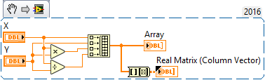

If you don't want to mess with what you already have, you can just collect all those outputs using "build array" as shown below:  This makes a 2D array of 3x3.
In your case, you would want seven 'build array' nodes, each with six elements.
For the first one, wire all the elements for the first row in your array. Then, in a separate 'build array', wire the six elements for the second row, etc.
This will give you six 1D arrays, representing the six rows. Then, wire each of these to another 'build array' and make sure it is not set to 'concatenate'.
That'll give you one 2D array of 6x6.
(But I still think you'll be much better off restructuring your program, and it's not that much work. I'd be happy to do that, if you can save your VI for an earlier version of LV, so I can open it.)

To answer your original question: There are two ways to do it, without messing up what you already have.  The first, as I already suggested, is to just collect all those outputs into 1D rows, and then combine those into a 2D array. For that, all you need is seven 'build array' nodes, and a bunch of wires.
The other approach, which I think you were asking for in the first place, is to construct the array inside the Formula Node.
To do this, first create the 2D array using a statement: "float ArrayName [6][6];". (Note that Labview use double brackets: [i][j], instead of commas inside the brackets: [i,j].)
Then, inside the formula node, every time you have a result that you want to place into the array, you just assign it as such: "ArrayName[i][j] = x+y+whatever;"
In this case, i and j will run from 0 to 5, yielding a 6 by 6 array.
Then, you create an output on the formula node called "ArrayName" and this will be a 2D array.
Here is a crude example showing a 2x2 array:Output Array.png
I shall go to bed tonight mourning the fact that I still haven't been able to access your code... but it looks to me that you have a straight-forward list of 36 calculations, so all you'd have to do is change the output variable from 36 separate variables, to one array variable containing 36 values.  I hope that helps.
