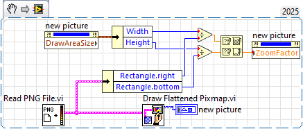

There is a property node for zoom factor. You can calculate the required factor based on image size and container size.

you may look at the slightly altered .vi from ravensfan from here
you need to scale your input image to the area size of image box
attached as labview 2020

Here's something I found on the board a long time ago
