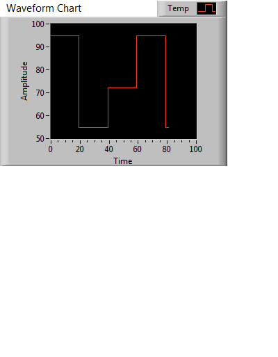

How do i add a graph behind my waveform .
How do i make a graph behind my waveform .
Example.

You have to plot those two parameters in the same plot. You can use the 2D array format of waveform chart to achieve this.

You can build the data and pass it to a single chart. Check the attached example and also go thorugh the LabVIEW basic materials.

Just check the attached picture. In the chart incase if you are not getting the 2 plots you may need to transpose the array. for getting two plots in the same chart click the y scale and duplicate it and then try the attached example.
Note: The attached example is just for showing multiple plots in a single chart.
good luck.

I understand about the multiple plots . but as you can see the picture . one is in wave form , one is square form .
Message 7 of 19
(3,688 Views)
Yes both has data right so you can plot it.

I see you are plotting the same data again with different colors. But as per your requirement you need to have different plots for different data. I don't understand what you are trying to achieve in the vi you attached.
