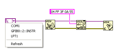

Hello.  I am having difficulty figuring out how to send a series of 5 bytes to my USB device on endpoint 2.  I know that endpoint 2 is a OUT endpoint so the device should be able to receive data.  I have already created a custom VISA driver and I am able to receive interrupt data on endpoint 1.  But what I cannot figure out is how to send data to my device.
For example, I want to send 04 FF 3F 0A 55 to my device so that my device can make a beeping sound.  How can I go about doing this?

You can use VISA commands to write to your USB device.  The USB Instrument Control Tutorial gives more details about using VISA for instrument control.
This is a very simple way to achieve what you are looking for, just select your USB device from the dropdown menu.  Make sure you use the right termination character!  That would be specific to your device.

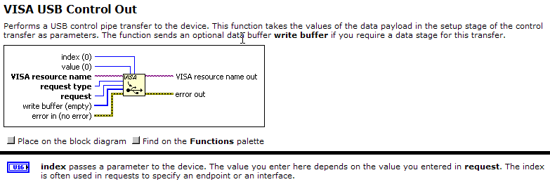

Hi Meghan,
Thank you for your reply.  This example does not send it to the correct endpoint.  I need the data to be sent to end point 2 of the USB device.

I apologize, I didn't clearly understand what you were asking.  If you need to specify an endpoint, you have two options.  One is to use the VISA USB Control Out VI, and set the Index to the endpoint you're using (pictured below).
The other option you have is to use a VISA Property Node.  Right click on the property node and go to Select Class»VISA»I/O Session»USB Raw.  Then you can left click on the word property and select USB Settings»Bulk In Pipe.  Then right click on the property node and select Change All to Write.  You can then input your specific endpoint.  (Pictured below)

Hi Meghan,
Thank you for your help.  I realized I needed to use the property node to set the end point and it works.
