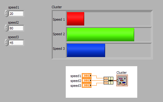

I have a need for something slighlty different, I wish to display several quantities in a horizontal bar graph, each quantity will only have one value. I modified your example to add two more "channels", and it works as I expect. (Attached, in LV8.5)
One thing I do not know how to do though, is what determines how thick the individual bars are (i.e. in the y-axis). In my example they are quite skinny, and I would like them to be much fatter, so that they are almost touching each other. Am I missing something simple here? Changing the line thickness does not seem to have any effect.
Also, is there any way to get the labels (speed 1,2 and 3) to display in the y-axis? I placed them there myself manually and am hoping there is a more elegant solution.

Well, I think you are looking in the wrong place and approaching this way too complicated. 😮
How about a cluster of three vertical progress bars, for example? 😄
If you want, just show the scale of the bottom indicator and make sure they are all scaled the same (see attached VI, LV 8.0).

Perfect!
Where do I have to go to hand in my LabVIEW badge? The complete irony of the situation is that I am using progress bars in the very same VI that needs to update the barcharts, and it didnt even cross my mind to use them! Thanks for pointing out what should have been obvious Smiley Very Happy
