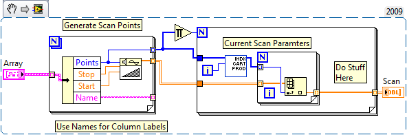

Given the number of times I have mentioned this recently I will nominate 'Cartesian Product' for the most common operation performed without knowing its name.  I use it a lot when taking data because it is common to scan over many different paramters.
Check out for instance this post:
http://forums.ni.com/t5/LabVIEW/3-loops-incrementing/m-p/1439422#M552998
The lower snippet is a subVI I use to find the indices for a given iteration with a given number of elements in each list.  I usually build a 2D array which holds the individual values for the scan parameters (assuming they are all the same data type).  Each row contains the points to be scanned for one parameter.  A separate 1D array holds the number of points in each scan  which is used in the subVI to find the proper indices.  The 2D array will be padded if the scans have different lengths, but these points will not be indexed so no need to worry about them.  Once I have the found the indices for a given iteration, I simply pick those columns out as I iterate over the rows of the 2D array.  (I'll try to find an example to post).
You may argue that the padded 2D array is not the most efficient, but when you consider that each point is a separate measurement, you will probably run out of patience in the lab long before you run out of memory in the array.
Message 4 of 9
(6,122 Views)
Here is a quick example:
Download the attached SubVI first if you try to use the snippet, mostly intended as a visual aid.

For the record, the example I posted does store the values in the second format you describe (with zero padding if the dimensions are of unequal lengths).  The subVI uses math instead of an odometer approach to index the arrays is the only difference with yours.
